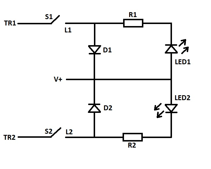

Based on the LocoFi Quick Start Guide on your website, four of your seven wires have the same color, polarity and function as the corresponding four pins on the NMRA 8-pin DCC decoder socket. The other three, the LED wires, are functionally the same but with reversed polarity. So, why is it not possible to connect at least the two track and two motor wires to an NMRA 8-pin plug and connect it directly to the 8-pin DCC decoder socket? (I need to work out a solution for the reverse polarity LED wires.)

You are correct in that the track and motor wires can be connected to the DCC ready plug as it is. However, lights are not as straightforward. See below for an explanation.
A simplified schematic of a typical light board is shown below. Please note that that only the portions relevant to lighting are depicted.
TR1 & TR2 – Track power
S1 & S2 – These switches represent if the dummy plug for DC operation is connected (switches closed)
L1 & L2 – Light outputs
R1 & R2 – Resistors (typically around 1k)
D1 & D2 – Diodes
LED1 & LED2 – The light LEDs
For DC operation, the switches would be closed and as the polarity on the rails is reversed, the appropriate LED will light up.
For DCC, the switches are open and the white and yellow wires connect at the points L1 and L2. V+ is common positive. Now the L1 and L2 are always HIGH when the lights are off. When L1 or L2 or both go low, current will flow and light up the appropriate LED(s). Typically V+ is 14V and resistors are up to 2k. The current flow will range from 5mA to 20mA depending on the value of the resistors.
Even if LocoFi™ module was common HIGH (V+), that would be a voltage of 3.3V and the LEDs will never light up due to the high value of resistors. LocoFi™ design philosophy (and it can be argued) was that the output go HIGH only when turned "ON" and the current sink to GND.
If you still want to plug into the connector, you will need to make the following modifications to the light board (hopefully the LocoFi™ module will fit along with the light board):
1. Reverse the direction of LEDs
2. Remove the diodes
3. Short the resistors (solder bridge or replace with 0R)
We hope that gives some insight into the design of not being able to use the light board. If we really wanted to use the light board, we will have to add circuitry to boost the voltage or drive the LEDs with transistors. If latter, the light output would vary (for fixed resistors) depending on the track voltage. This will not only make the LocoFi™ module larger and considerably large as we plan to add more function outputs in future for gaining literally nothing but also lose the flexibility that comes with LocoFi™ being operable on a variety of track voltage.
The light board was a DCC specific design for compatibility with DC. With LocoFi™, it doesn’t matter if the power source is DC or DCC. It simply works.

With LED forward voltages in the 3 to 3.3 Volt range, I agree that 3.3 Volts is not going to provide a usable amount of light from the LED if there is a 1K series resistor. You must drive the LEDs directly from your logic outputs.
