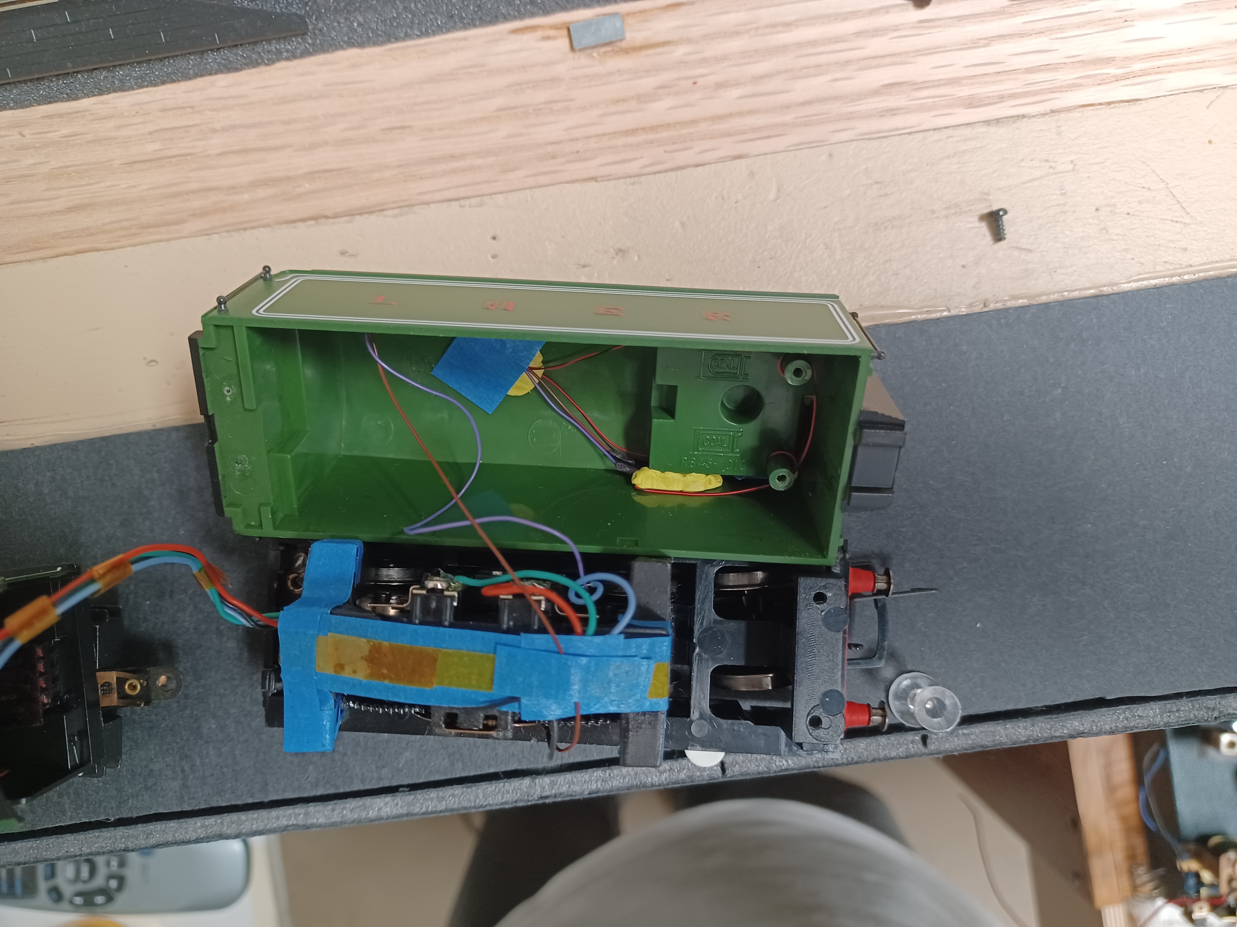

This loco is about 30+ years old! It is tender driven. Pickup is from the loco wheels as well as the tender wheels. I had to remove the two center wheels from the tender so that I could modify the pickup from the tender wheels. It has a three pole pancake motor. What I noticed is that it tends to slow down on irregular areas of the track unlike the diesels which are long and therefore they have better pickups.

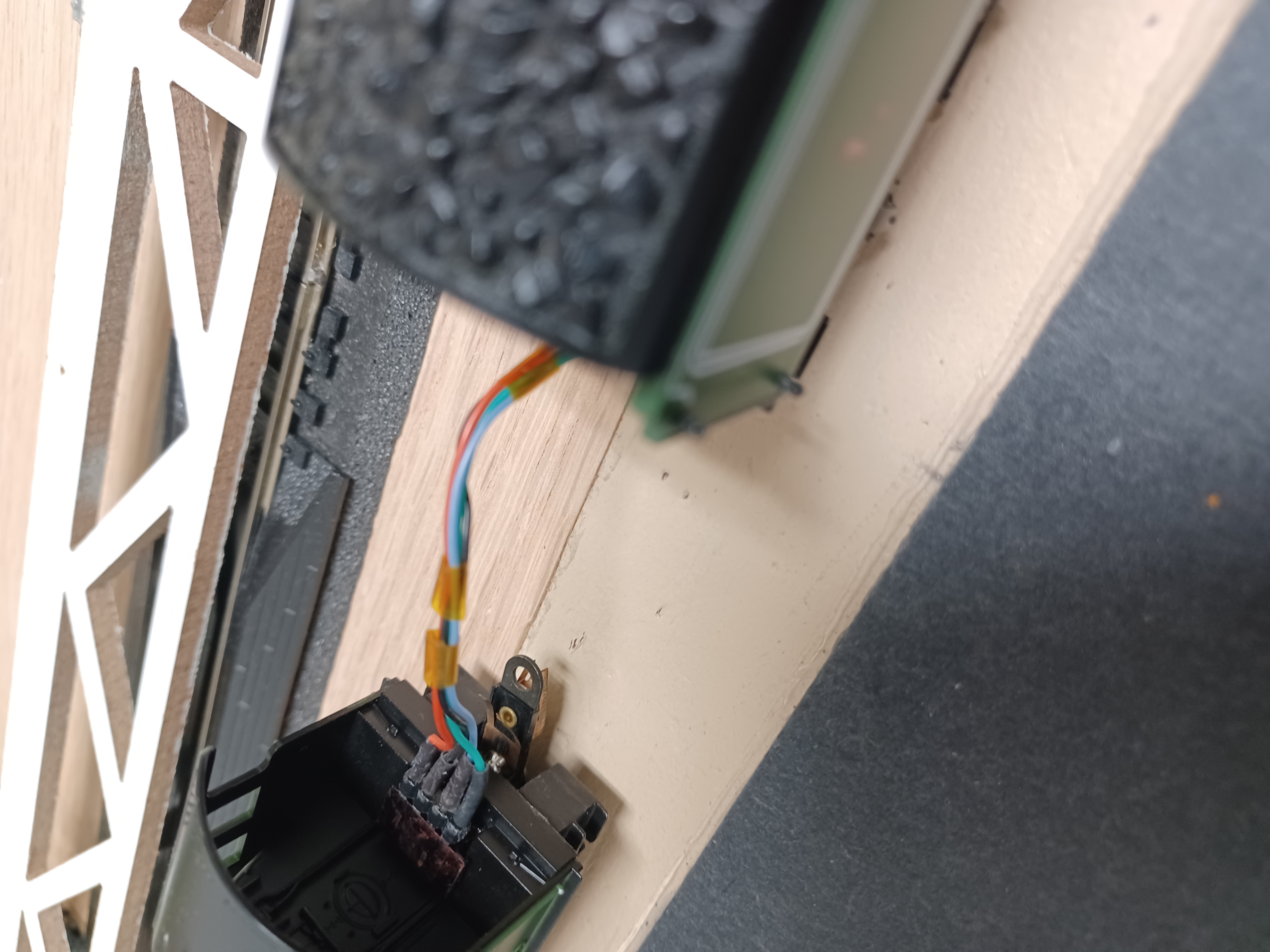

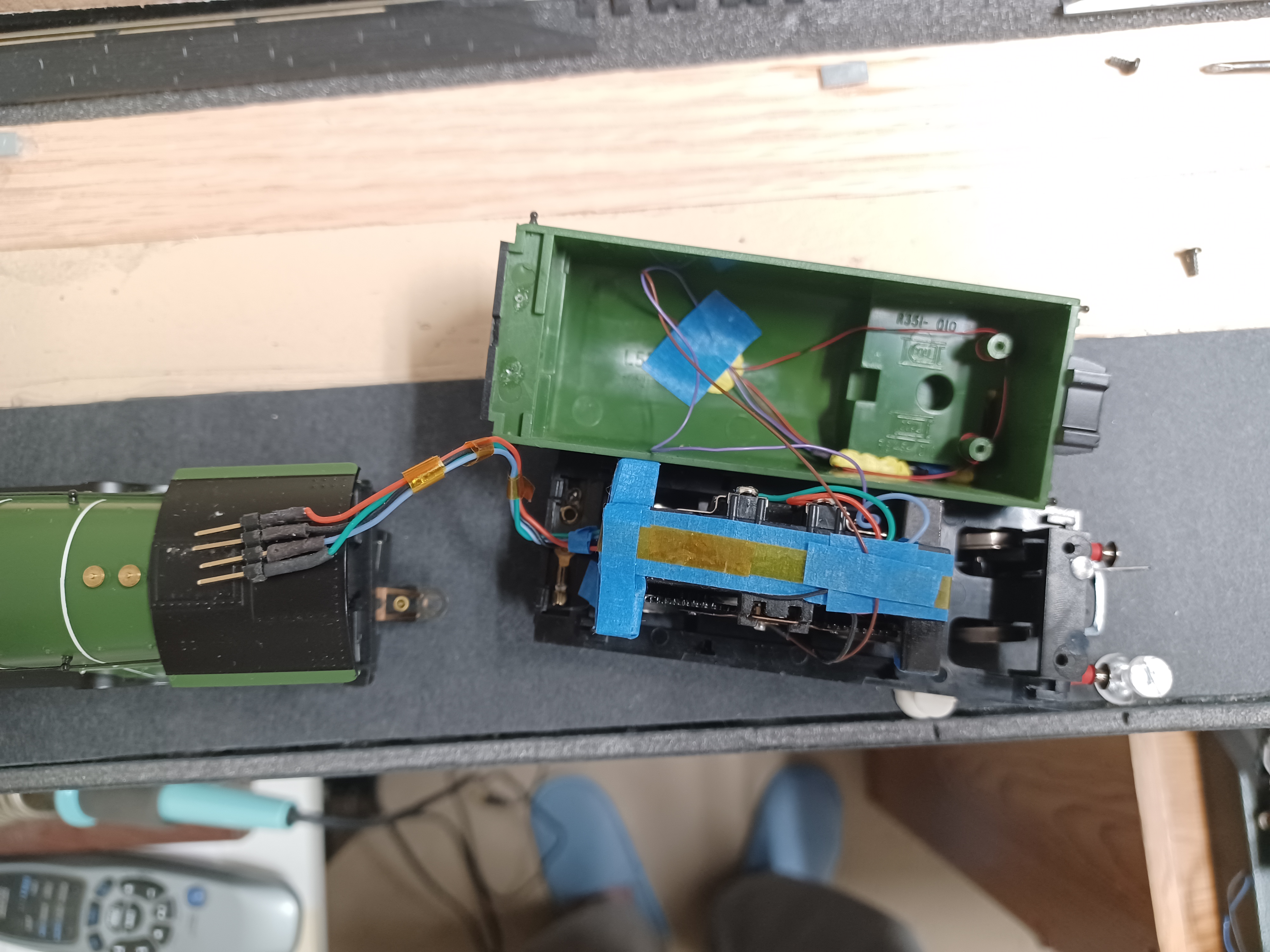

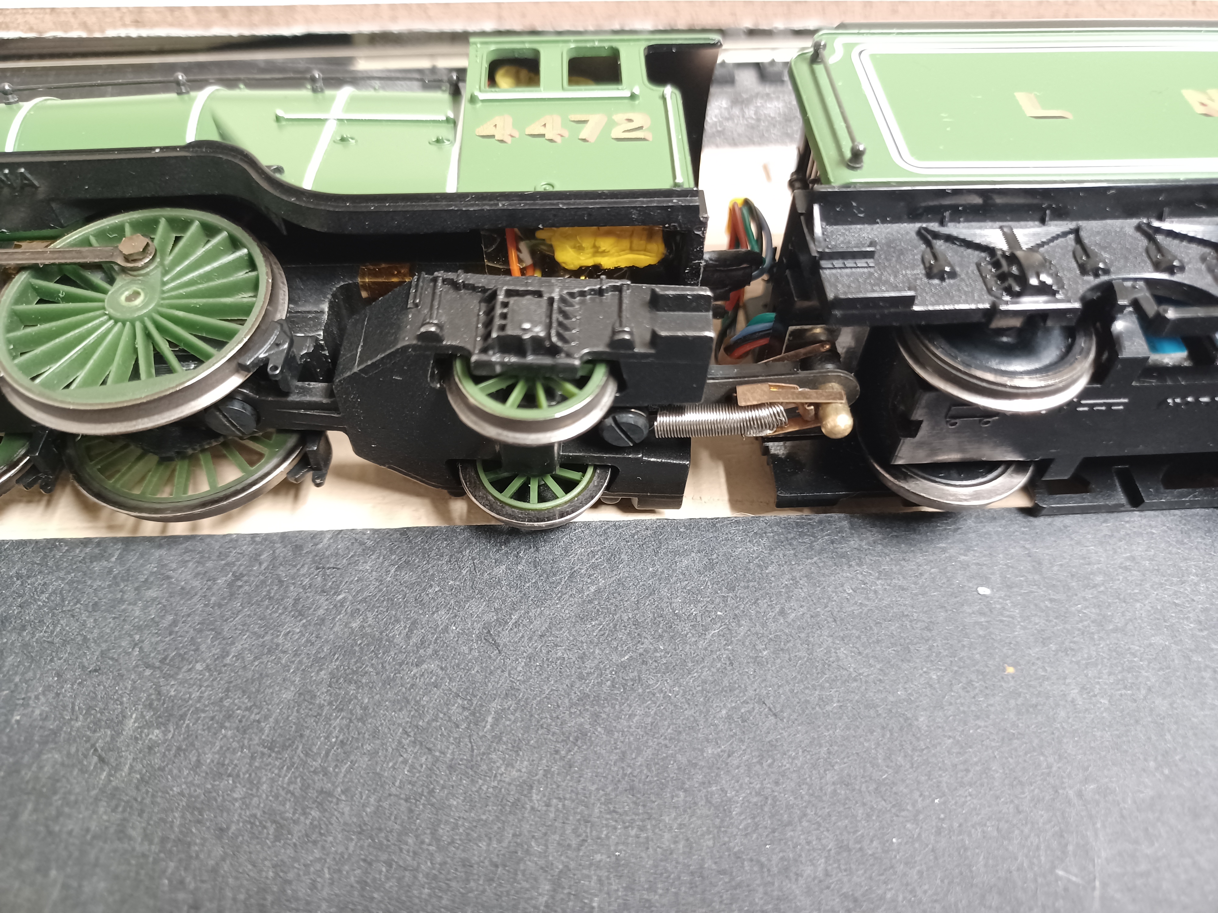

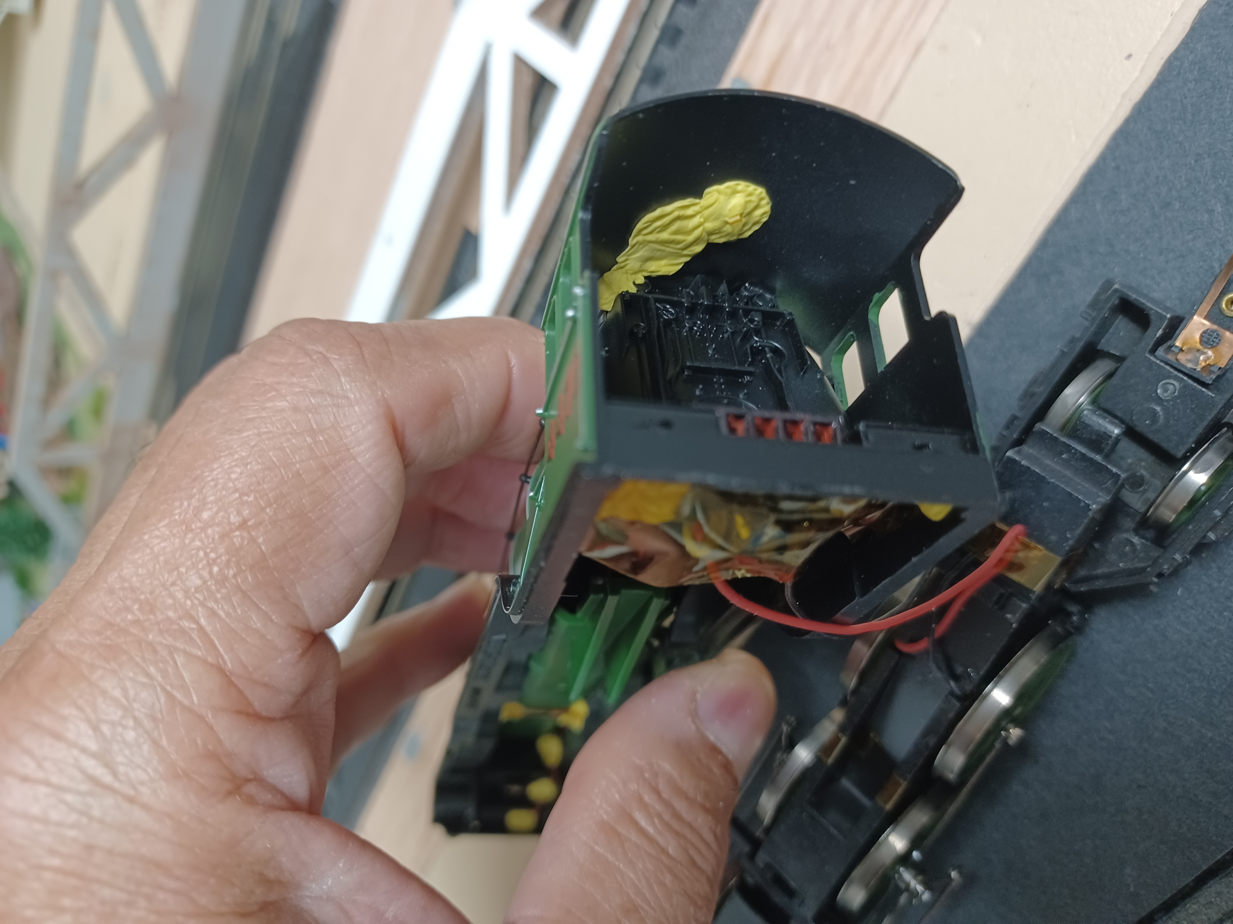

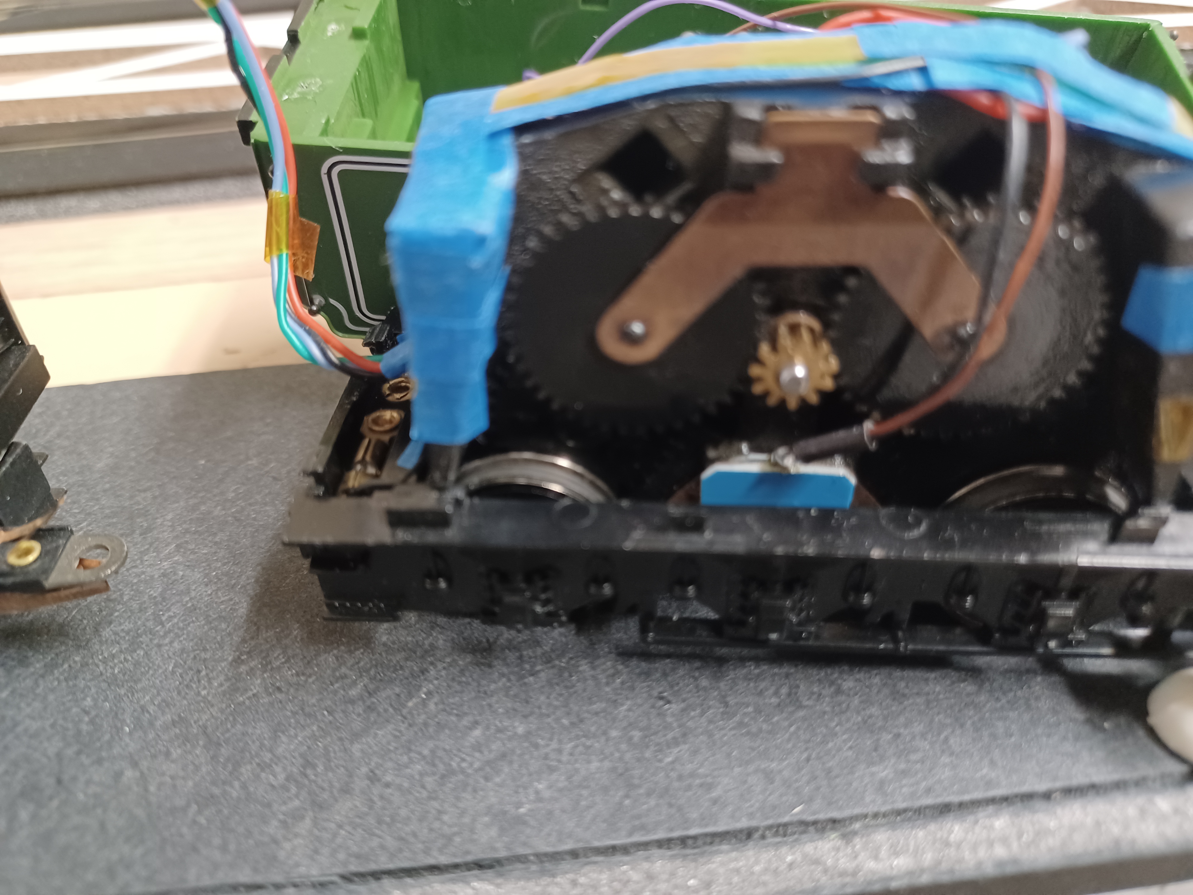

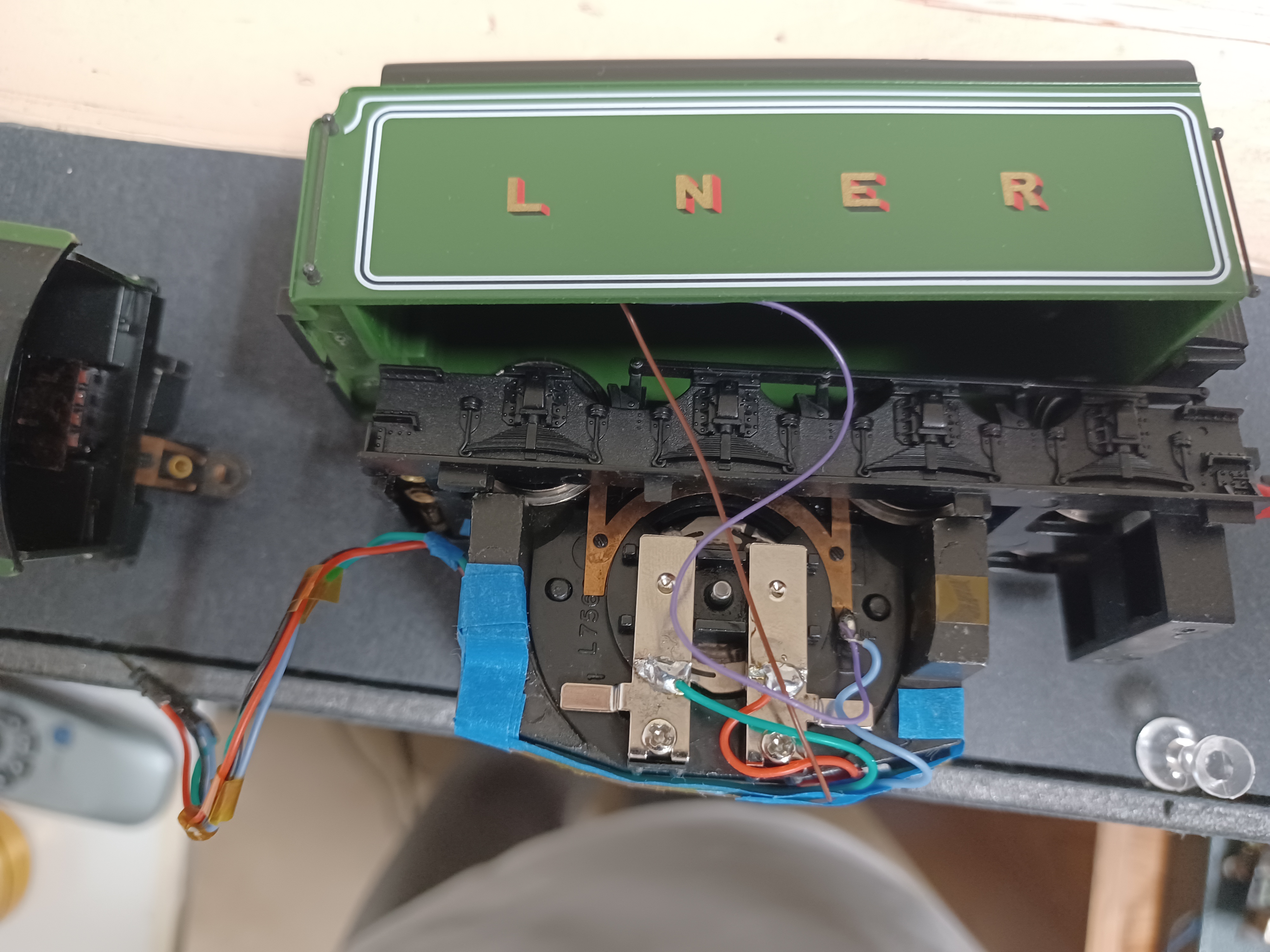

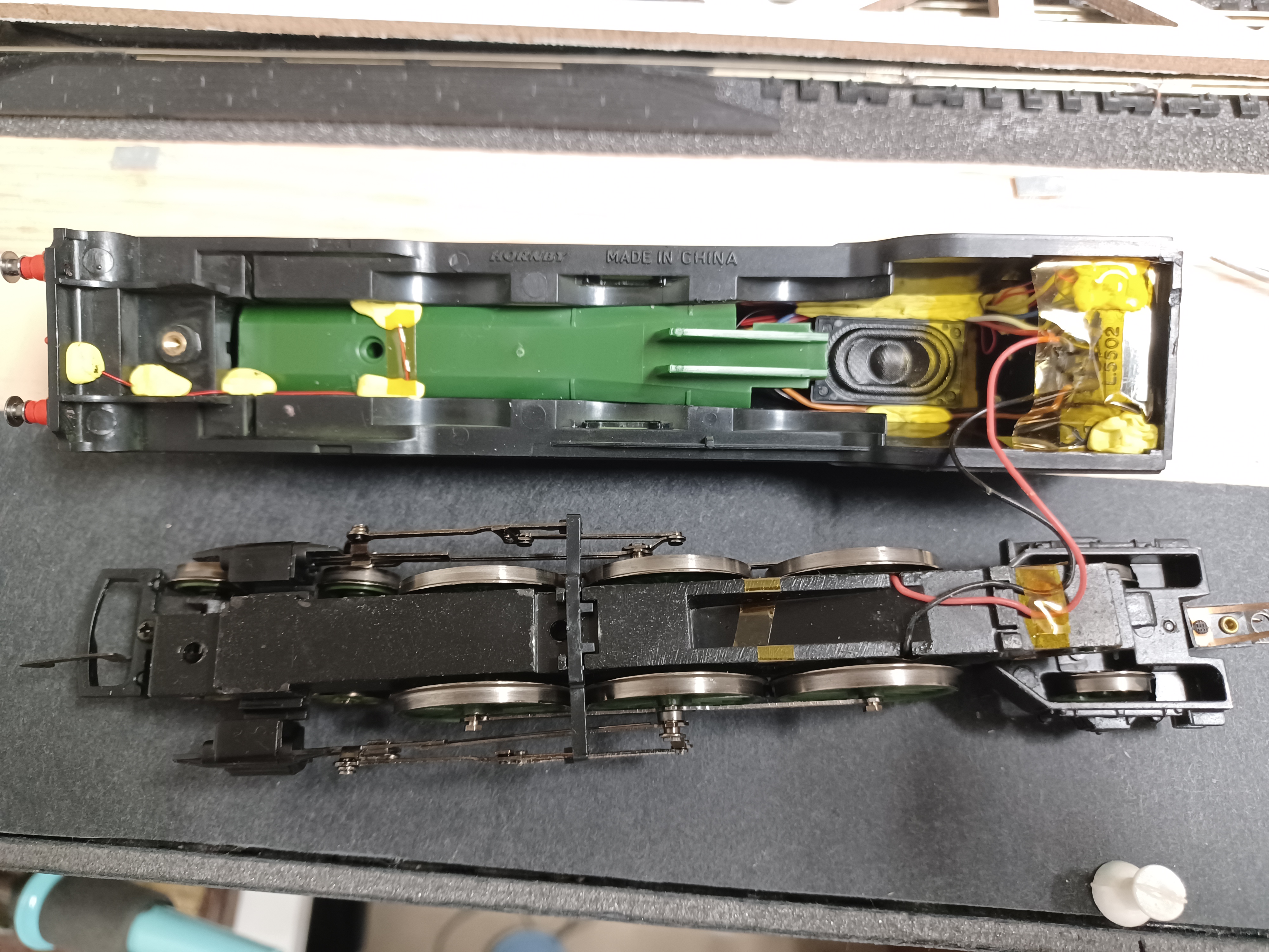

Below are some photos of the interior details of the installation of LocoFi. The unit is inside the boiler section and hidden. Speaker is visible.
