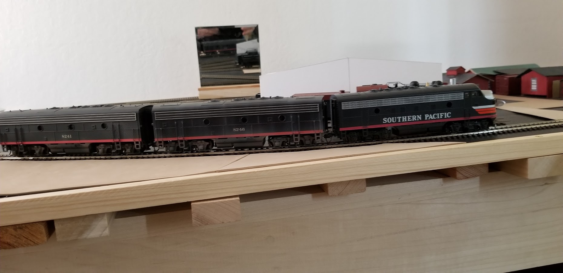

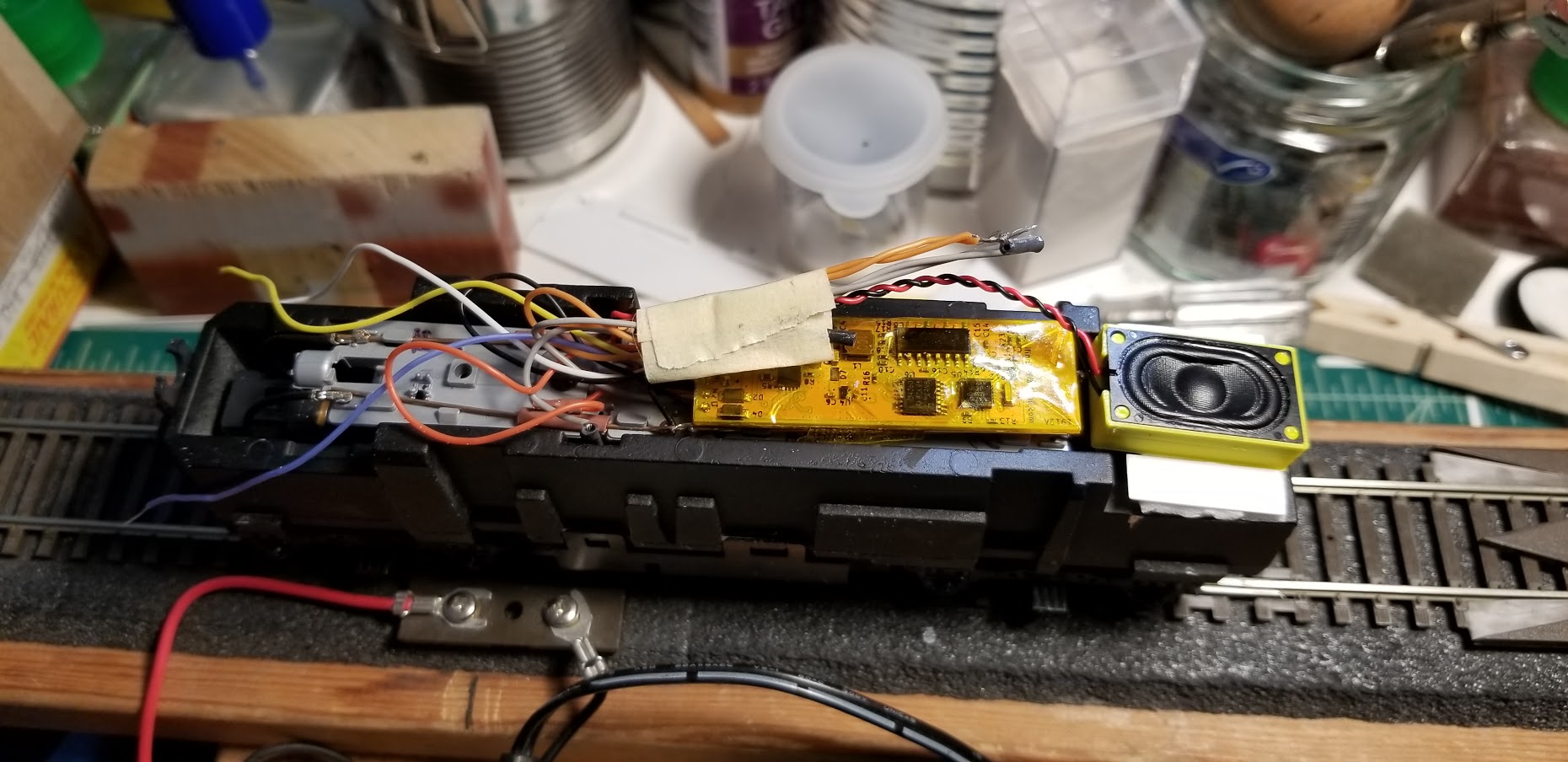

There were several initial challenges in setting up my experiment with LocoFi. I used a Kato/Stewart F7 unit (now Bowser) as the test bed as it was not DCC ready but still had an isolated motor. It turned out the heavy diecast chassis was too tall and I had to remove the fan vent insert on the top of the locomotive shell to get the receiver to fit. I shaved the bottom of the plastic fan casting so it now clears the receiver and glued it in with canopy cement in case I need to use that access.
The Kato/Stewart unit is difficult to convert to LED lighting and I need to get a more amber glow LEDs anyway to simulate 1950’s headlights. Also there is no need to use a backup light but I would want to use the 2nd headlight (it’s and SP Unit) as a MARS light.
I chose an F unit diesel as my LocoFi trial unit as the steam setup is still in development and they are appropriate for my 1949-53 modeling timeframe. Also the B units can serve as locations for an Amrit Device and ultimately batteries for dead rail operation independent of track power.
Setup was a bit challenging as like most more recent US home WIFI routers my 2 year old router is dual band with both a 2.4 MHZ and 5 MHZ band. My preference for home WIFI is the 5 MHZ band and all devices such as my cellphones, notepads, printers and cameras are configured to use that band in my house. As the LocoFi receiver only works on the 2.4 MHZ band I had to set up another logical receiver on that band. Rather than switch my phone back and forth to the 2.4 MHZ band, I bought an inexpensive Fire Tablet and am using that for LocoFi communications with it configured to the 2.4 band.
Running under LocoFi
