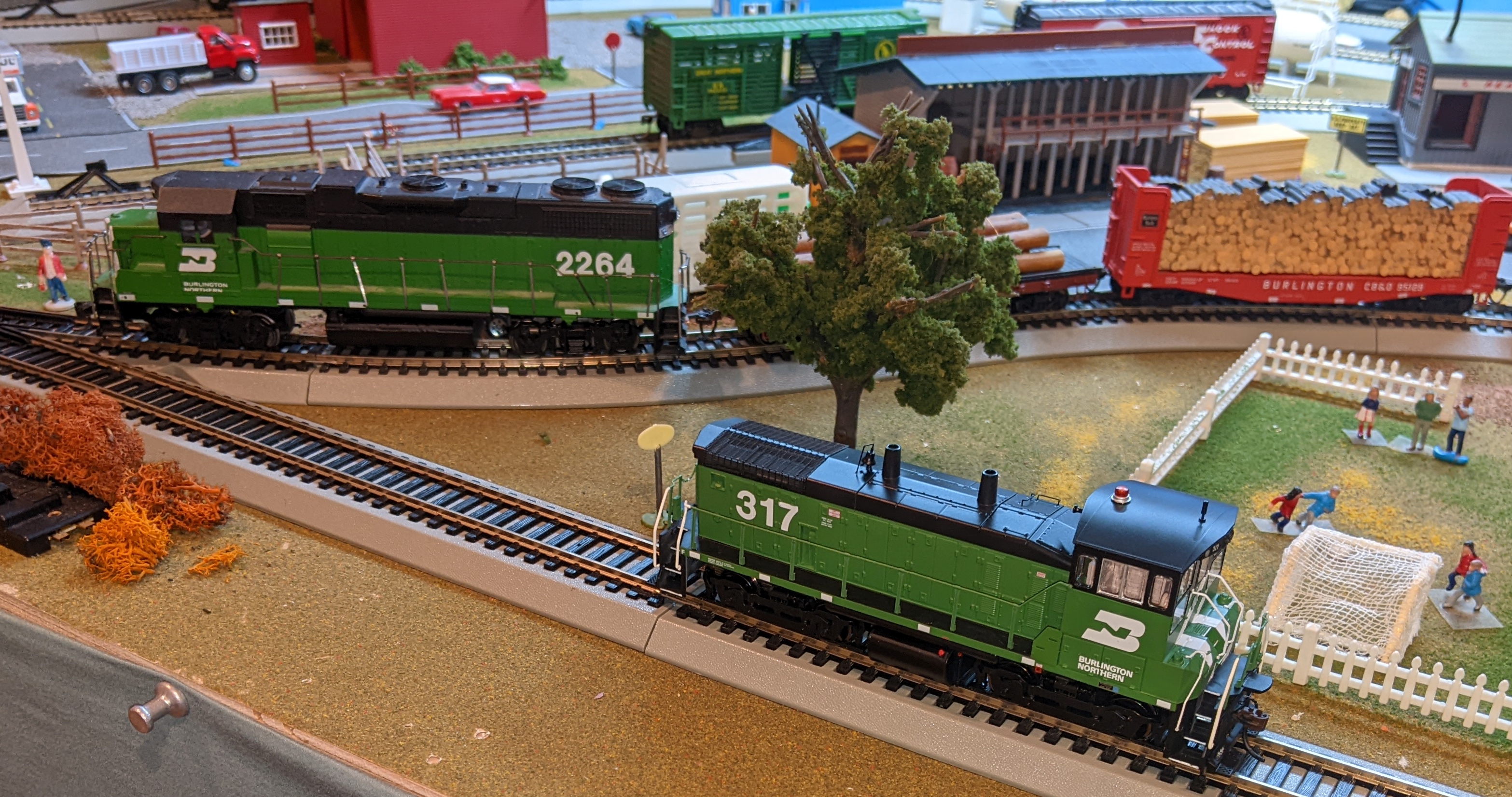

LocoFi™-ed SW-1500 (right) ready to take over switching duties from the GP38-2 (left).
