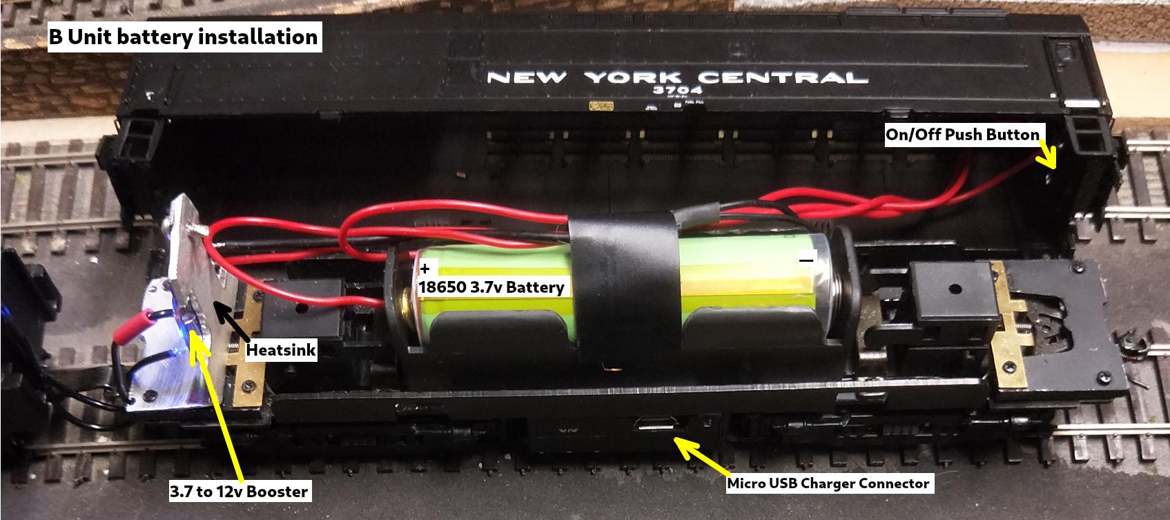

        I have recently been assisting Kiwa in setting up battery power for his LocoFi setup.
migrating from DCC. I’m not a ‘modeller’, per se, although Kiwa reckons otherwise,
but I am a retired electrical/electronics engineer.

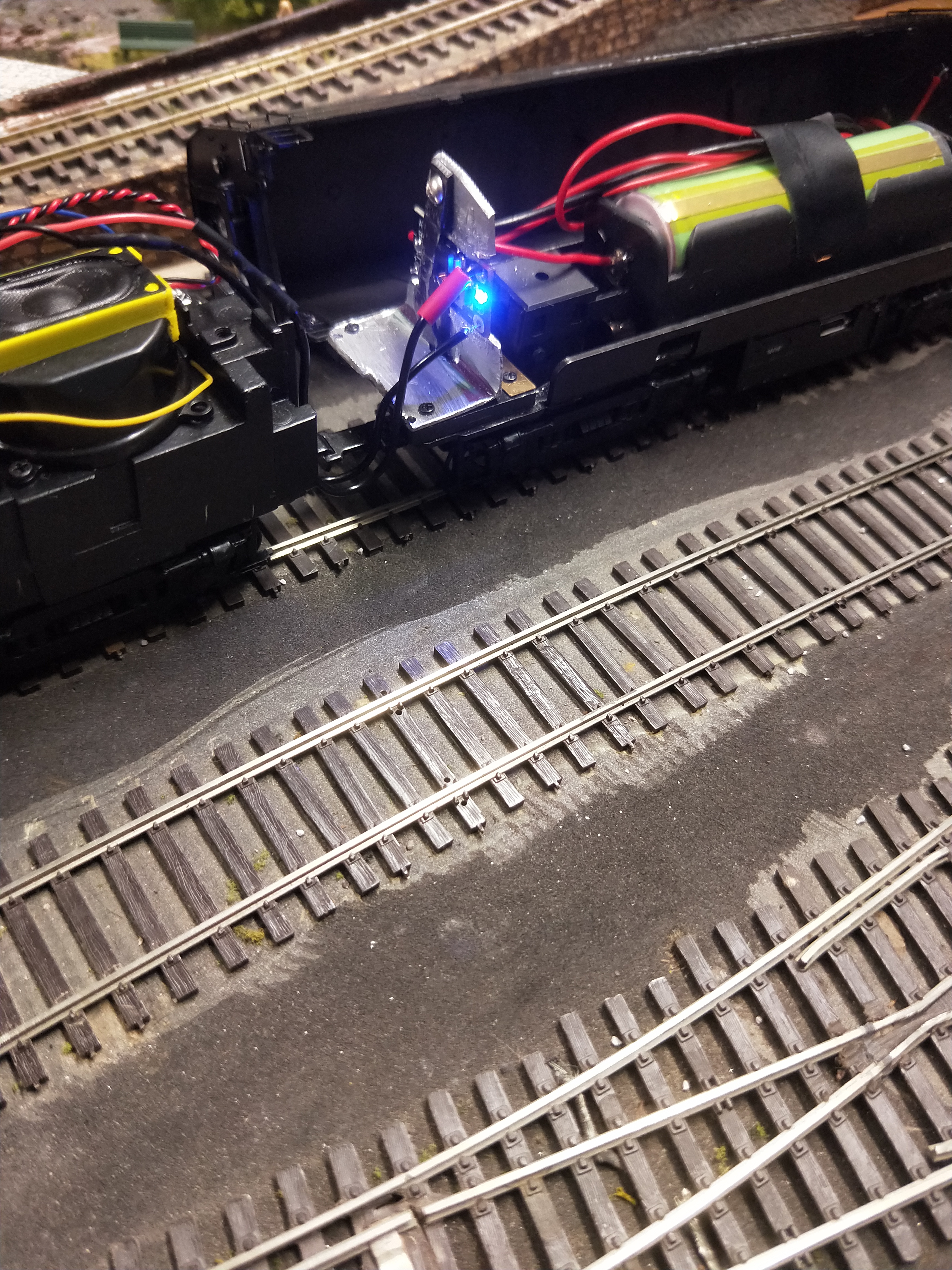

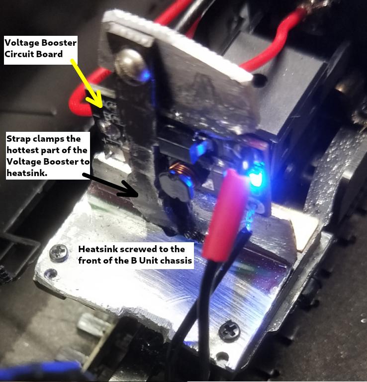

        We found little problem, overall, and the first loco worked out well, apart from an
overheating Voltage Booster, which a heatsink solved and handily allowed a 100% overload
capability as a bonus.

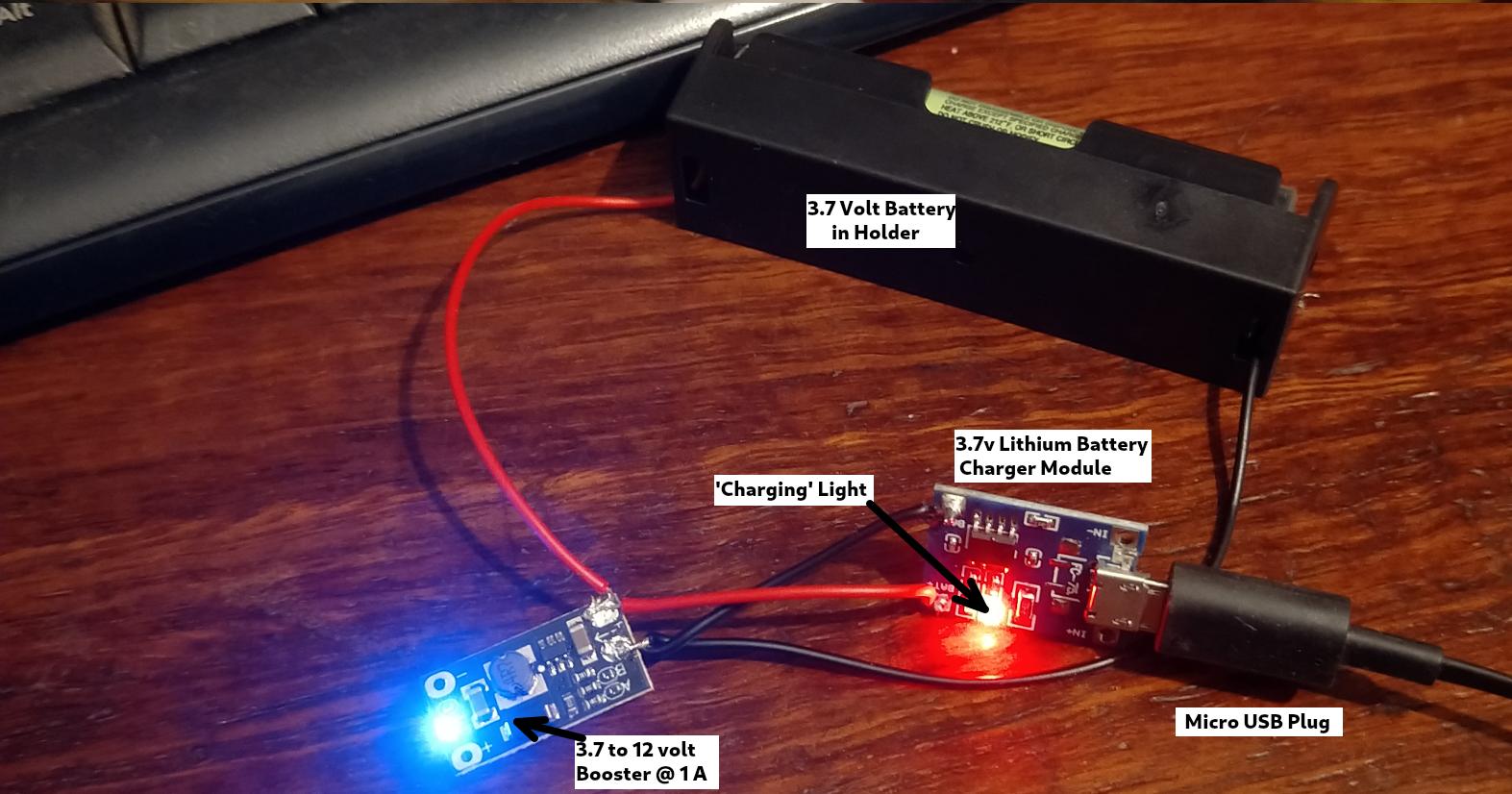

        I searched around the internet and found that for a few cents each I could source from
China a tiny USB mini 1 Amp, 3.7v battery charger about the size of a postage stamp and a
Voltage Booster at half that size that took the 3.7 volt battery output up to 12 volts at 1/2 Amp.
I briefly scanned the specs for this PCB and in place of the ‘One Amp Peak’ I saw ‘One Amp’.
So of course the thing ran awfully hot, so Kiwa fashioned a heatsink from a scrap of Alloy
angle and this gave use ‘Cool Runnings’ even at a full one amp continuous output.

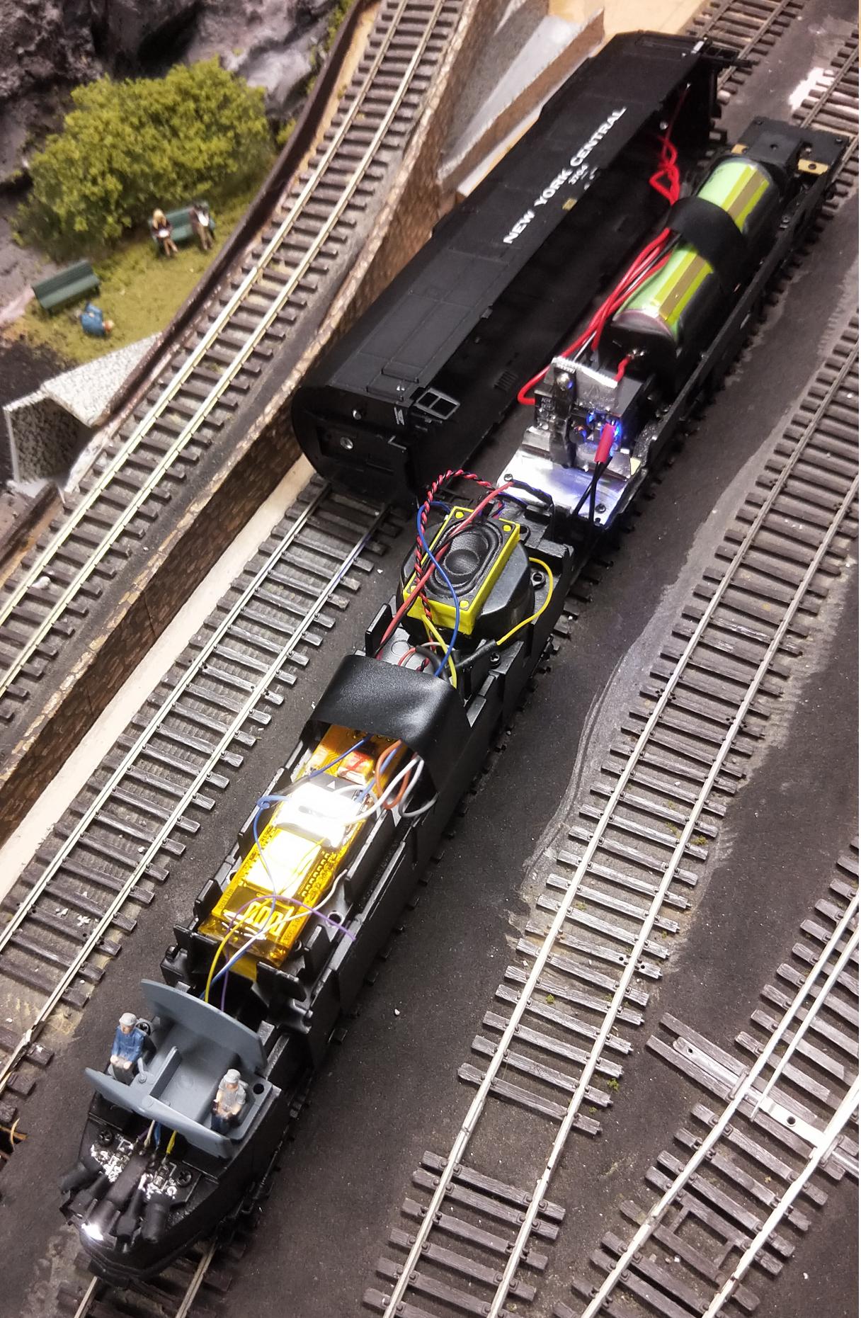

        The little loco flies around the full layout, at full load,

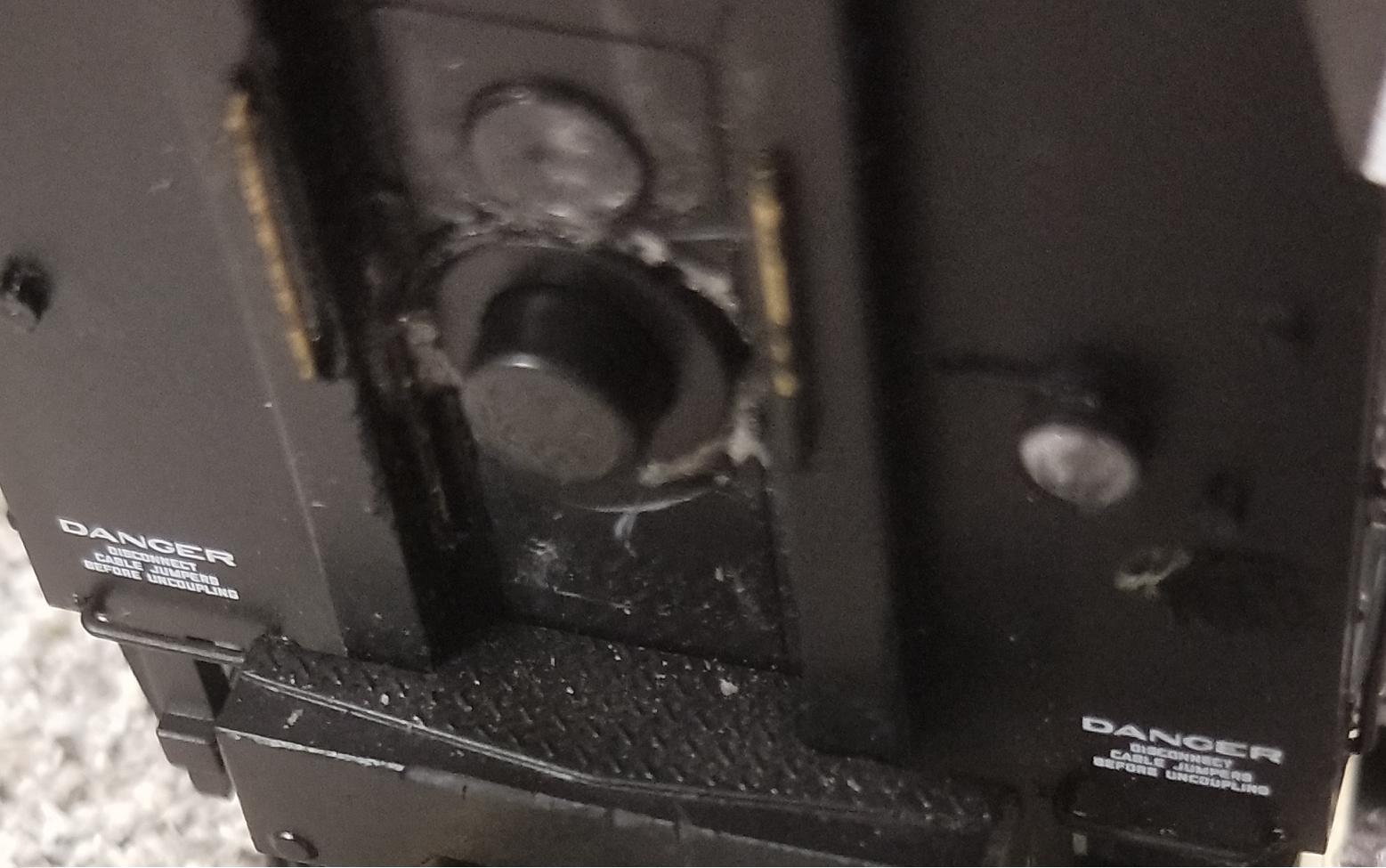

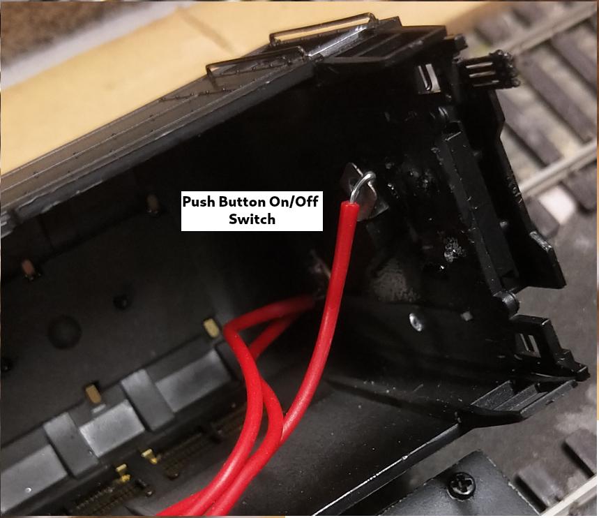

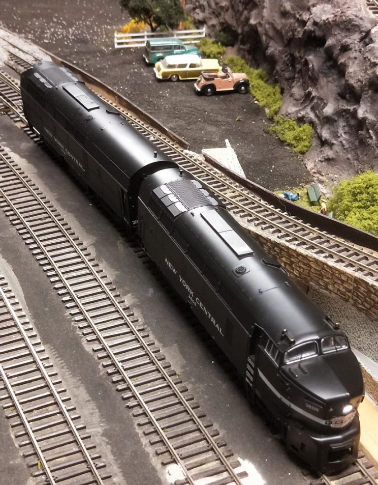

Thank you for the great write up! A nice primer on electricity basics too!

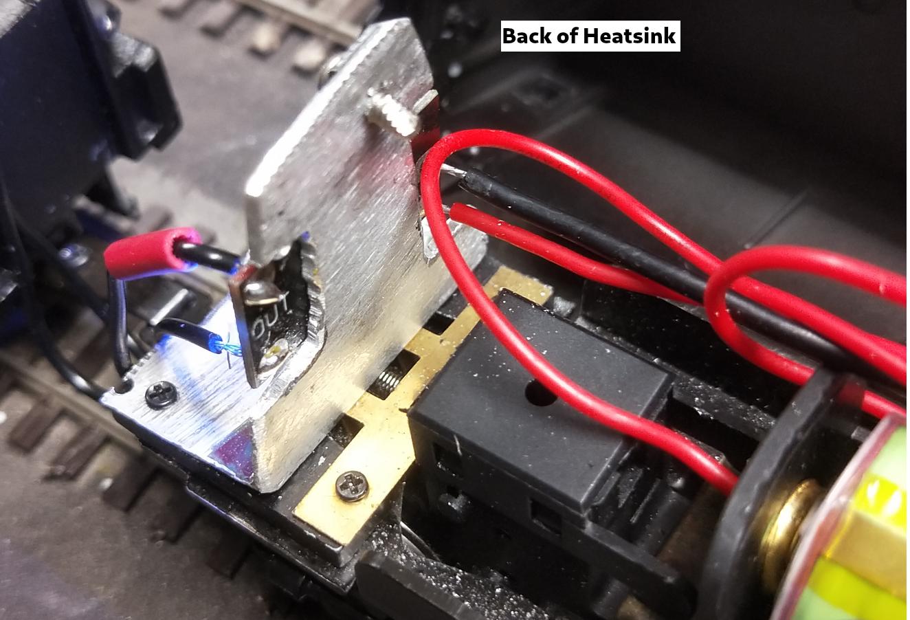

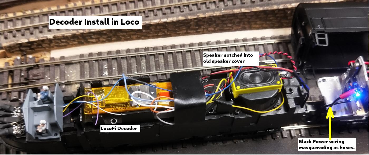

Here’s some install pictures (sharing with Ron’s permission) to go along.
Posted : May 19, 2023 10:20 pm
