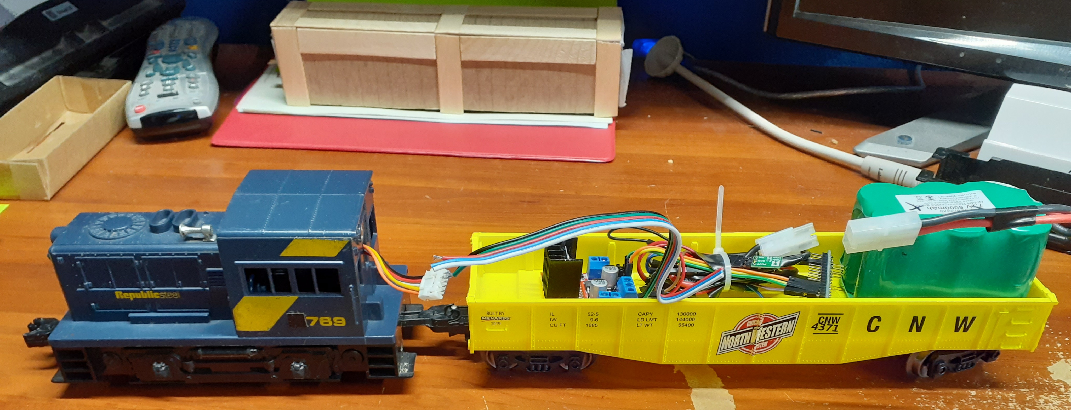

I was curious about the loading John. I have some HO stuff inside and currently running the G on DC. Right now it’s just a small layout and the grandson enjoys running it around in a oval with a siding. But at 12 that wont last long.. He has been helping me build the layout and does enjoy it. I hope he learns something also. Like I had mentioned previously I’ve started working on the 2-rail O but the weather here in Kansas hasn’t cooperated lately. The humidity has been as high as the temperature so even in the evenings it’s been miserable outside.
Below is a picture of a test that I put together with blue tooth and not sure yet how I’m going to work all this yet and for which engines but right now what I was thinking was to have a trailing car with the electronics in it with a common plug. That way I could use what ever system I wanted for a particular engine. And if you notice in the background I built a crate to put over the electronics in the gondola. I know that’s a heck of a battery.. Got that for the G stuff.
Thanks for the info about the current. I was concerned about that because I really like the locofi concept and would love to use it across the board eventually. It might work ok in these small engines for now without any mods. I’m not sure what the starting load is on them. And thanks I’m all for not re-inventing wheels.

My friend and I have discussed the idea of putting all electronics in a trailing car or a steam loco’s tender when outfitting a conventional O-gauge locomotive with LocoFI if it did not have sufficient room in the shell. Again what is power requirement of your locomotive to get it moving and pull your calf. Size of wire from control board in calf to locomotive motor may need to be increased. Three wires for loco’s headlights should be ok at lighter gauge.
You need to find the amp draw of your motor to see if LocoFi will work. It is as simple as that if it will work or not with HO LocoFi board.
I don’t know what you mean by “the HO stuff inside” please explain what it is. I do see a big heavy battery and some electronics but can’t make out what it all is.
Maybe look into NWSL and see if they have a G scale Stanton drive and what its amp draw is at stall and use that to power your loco with LocoFi.
We are all playing and there are no set rules only that you need enough power to turn the motor and that LocoFi board can only deliver so much and no more without designing a “magic boxes” to interface with motor and LocoFi. From what I get from Karin that is what she is trying to do. We have abandoned that idea as being costly, time consuming and temporary so we will wait until LocoFi comes out with an O gauge board to convert our conventional locomotives with LocoFi. We don’t see the need to reinvent the wheel for a short time gain.

Dan Bader
(@danbader1)
Posts: 6
Hello All,
Sorry I should of explained a little more. The “HO stuff inside” meant that I have a bunch of HO stuff inside the house in a tote but haven’t gotten it operational yet. Sorry for the confusion. lol… As far as what you see in the picture it is an Arduino with bluetooth, a DC to DC up converter and an L298 motor driver. I have tested this on an old G scale and it works fine also on the O. I found this at arduinorailwaycontrol.com. It is pretty much a build it yourself kinda site.
As far as the O scale, last night the little loco in the picture showed a load of 1.2 Amps at stall.

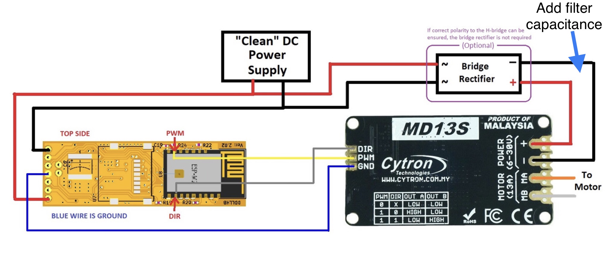

(@jimmydopson)
Posts: 4
I had a brainstorm (someone asked if that meant it was raining in my head?).
The plan below (which I had planned to implement in a G gauge GP7) could instead be used for a simple ‘one-train at a time’ layout for running various locomotives.
Without installing a LocoFi™ module in a locomotive, but by feeding its power-input and the power-input for the H-bridge from the track-power supply (instead of from the locomotive’s track-pickups); the ‘motor’ output of the H-bridge could feed the track (no need for the bridge rectifier and capacitors). With it, any one of several locomotives (even some too-small or too-cute to house LocoFi™) placed on the layout would then be LocoFi™ controlled. The LocoFi™ sound could also be used externally, and maybe input to a speaker-system. An automatic ‘back and forth’ controller, that does interest me, between the H-bridge and the track connection, might be workable with it, too.
