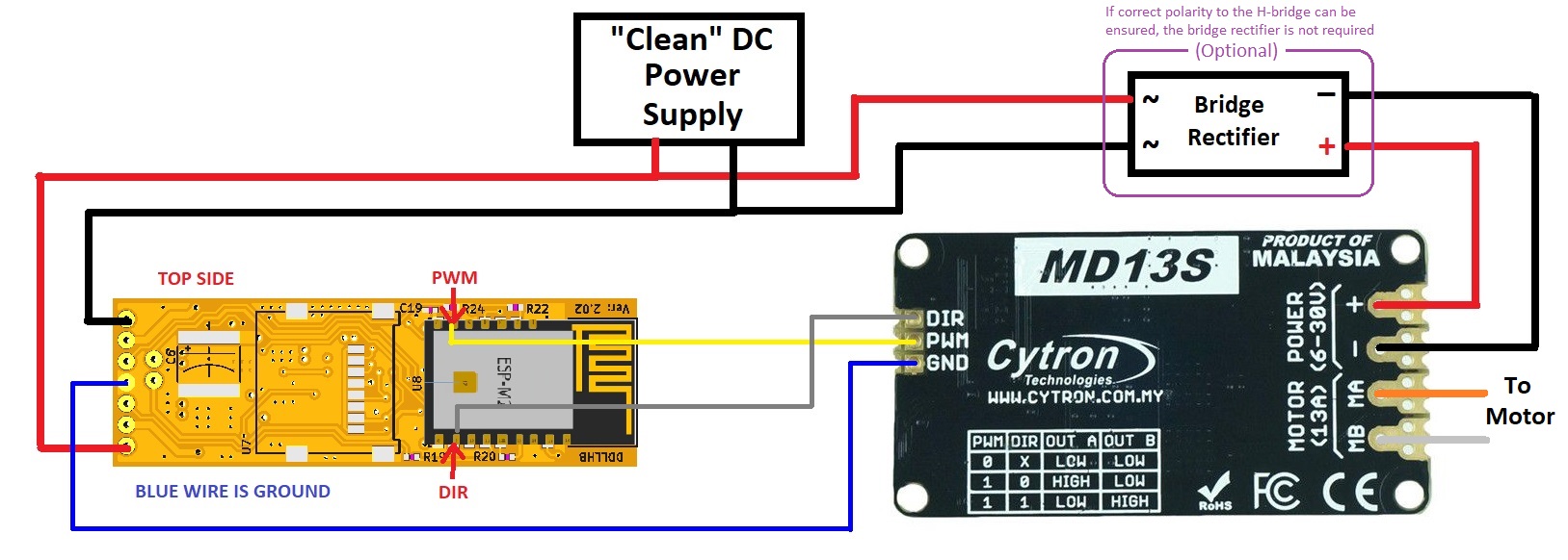

This question is primarily to Karin (I understand that she made similar work), but to anyone. In her diagram, did you use the M1/M2 to your H-bridge, or use DIR and PWM from a micro-controller?
I plan to use a G gauge locomotive; use a LocoFi™ module; drive a MD13S H-bridge; use a 24 volt, 15 amp track-power module; construct an intra-locomotive power supply for the MD13S.
All hints or ideas are appreciated!

Until a full-fledged LocoFi™ module for large scales is available, the following setup (applies to LocoFi™ 3 only) can be used for higher amp motors. It applies to any large scale (including G and O) as long as there is space to fit them all.
Please check out LocoFi™ for Large Scales (DC and AC power) for the latest offering.
The “clean” DC power can be battery or even AC that had been rectified and filtered. Please note that MD13S is only an example. Any H-bridge that accepts DIR and PWM as inputs can be used instead.

Virtually my exact plan; with the addition of capacitance on the DC side of the bridge rectifier for any dirty-track issues. Planning to add a sound-amplification module and a fuel-tank speaker.

I have received two MD13S modules and will be retrofitting a 2 rail and 3 rail high amp draw O-scale locomotive after LocoFi modifies existing LocoFi 2 boards. Will also install bridge rectifier in both locomotives to prevent any accidental current flow issue when operating on our club’s layout. From what was learned in 2019 when trying to do this there should be no problem in getting high amp draw locomotives operational at a reasonable cost and ease of modification.

I believe the MD13S will be an ideal H-bridge for interfacing a modified LocoFi™ module to a higher-amperage locomotive.

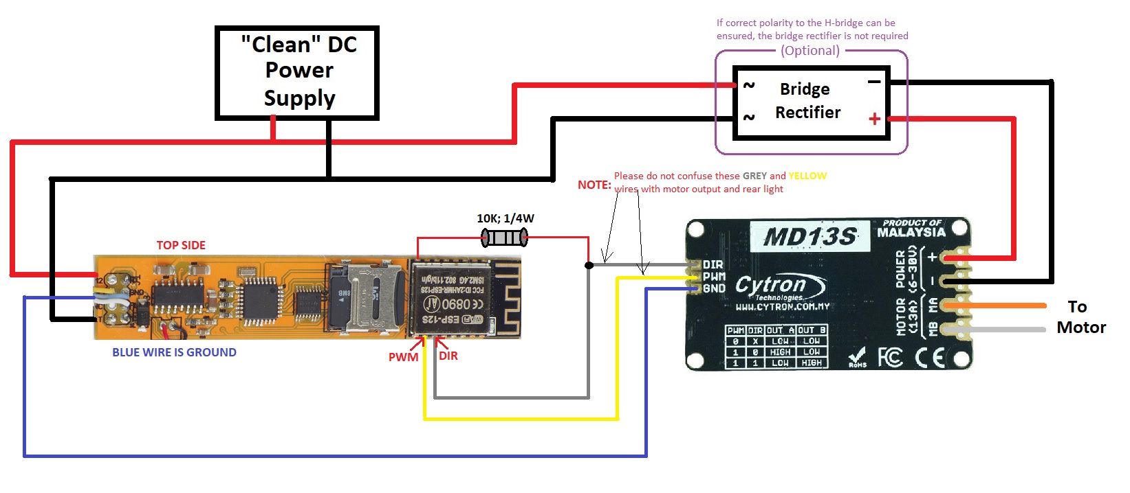

Here’s the schematic for DDLLHA in case someone wants to DIY interface to external H-bridge. Please note that MD13S in only an example.
