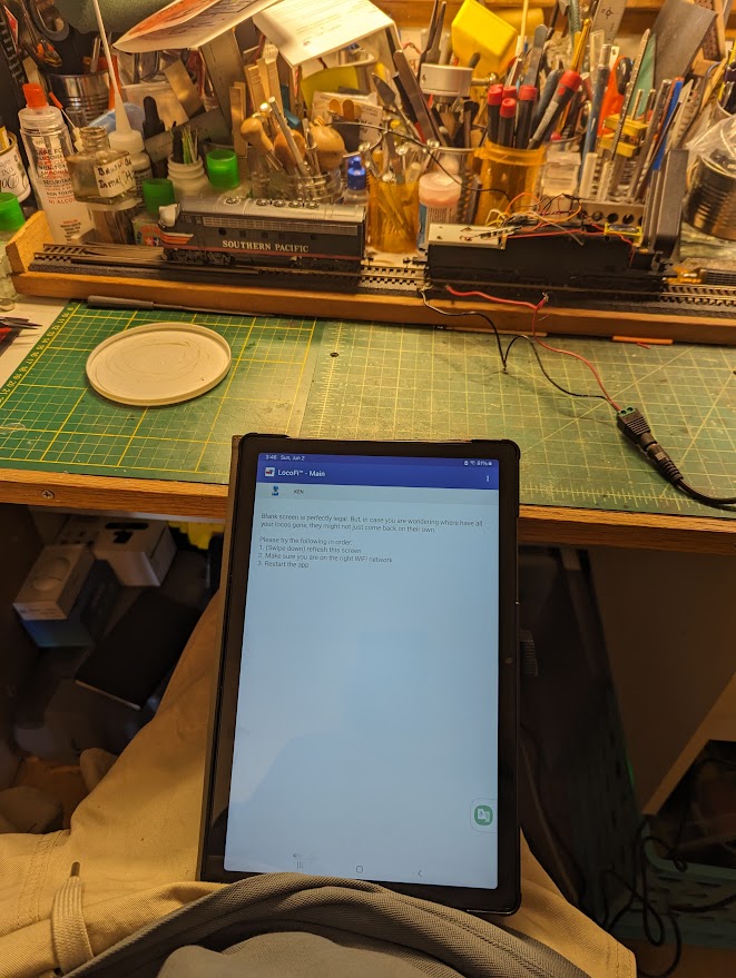

this is the test setup with the loco on the left showing up in loco list and new loco on right not.
Look closely and the existing install shows on loco list

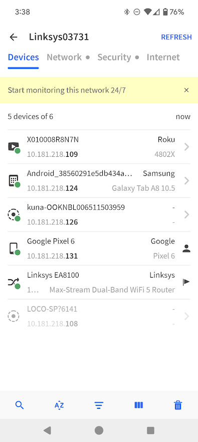

list of wifi devices on home network showing new loco does not appear.,
Not visible on the tablet in the screenshot.
Yes. It is because it’s not yet added.

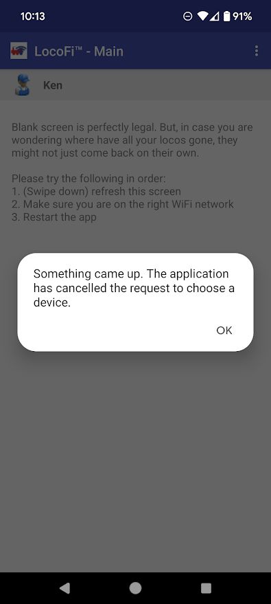

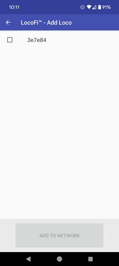

I have added LocoFi to my Pixel 6 Android version 14, latest patches and security updates applied.
I ran through the add sequence with both locos on the test track to verify app is working correctly.

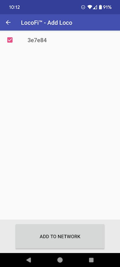

I screen captured the sequence and converted them to jpg format.
1 Main Screen before add sequence
2 Add screen after selecting add locomotive

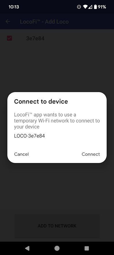

3 Add screen after selecting locomotive to be added
4 system response to add locomotive
4 system response to add locomotive after about 2 seconds

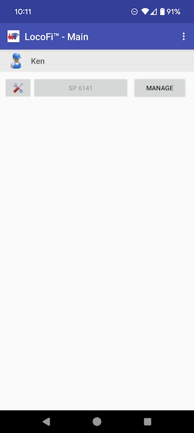

6 Main screen after add sequence failure

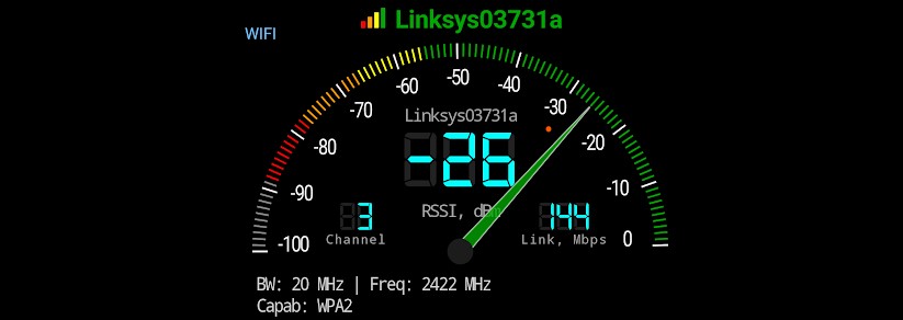

Note that the network is 11 a/g
LAN Specifics
As you can see this is in the 2.4 ghz band.
Hope this is helpful
Posted : June 3, 2024 9:52 am
@Ken Adams
Thank you for providing all the info.
In step 4 (‘Connect to device’ dialog) above, did you click ‘Connect’? It should be clicked on rather quickly.

I just reran the sequence and with a quick connect click I still got the "Something came up. The application has cancelled a request to chose a device"
Posted : June 3, 2024 12:43 pm

>I just reran the sequence and with a quick connect click I still got the “Something came up. The application has cancelled a request to chose a device”
It appears that something on the phone is interrupting the process of making a connection to the LocoFi unit. Note that it is an issue of Android not being able to connect to the LocoFi module to be able to transfer the WiFi router credentials and initiate a reboot of the module, not the module unable to connect to the WiFi router.
>Can you check the code to see what condition triggers the “Something came up. The application has cancelled a request to chose a device”?
This is an Android generated dialog and error message (as part of their recent enhanced security related fixes). Since an app can try to connect to another WiFi network, this prompt is yet another check (even after granting the permissions) to confirm from the user if that is really what they want to do. We have no control over it. Doing (ironically) a ‘Google’ search reveals that it’s a common problem with some Android devices.
However, we have plenty Pixels including 6 and 6a running Android 14 and have not seen this issue on either.
Some of the other things you can try before attempting to ‘Add Loco’ (although we are able to add locos on our Pixels successfully without doing these) are:
  1. Turning off Bluetooth.
  2. Turning off Mobile Data.
  3. Making sure you start with connected to your WiFi network and entering the correct password.
If this also fails, there’s two more options:
  1. Try to reset the network settings of the phone. Warning: Please note that you will lose your network settings e.g. all the saved networks and their passwords, etc.
  2. Try another smartphone (if you have a spare lying around) to do the ‘Add Loco’ part.
Note: Please remember to revert back to your original settings e.g. re-enable your Bluetooth and Mobile Data again after you’re done adding the loco.
For future, we strongly recommend using a dedicated phone without a SIM card and running at least one or two revisions older version of Android. This is not the first time that each upgraded Android tends to break plenty of apps (except probably video games and others that generate a lot in ad revenue) in the name of security and it takes time to come out with fixes. For a list of currently < $40 phone deals, please check out the thread: https://www.wifimodelrailroad.com/forum/locofi-tm-general/cell-phone-for-controller
