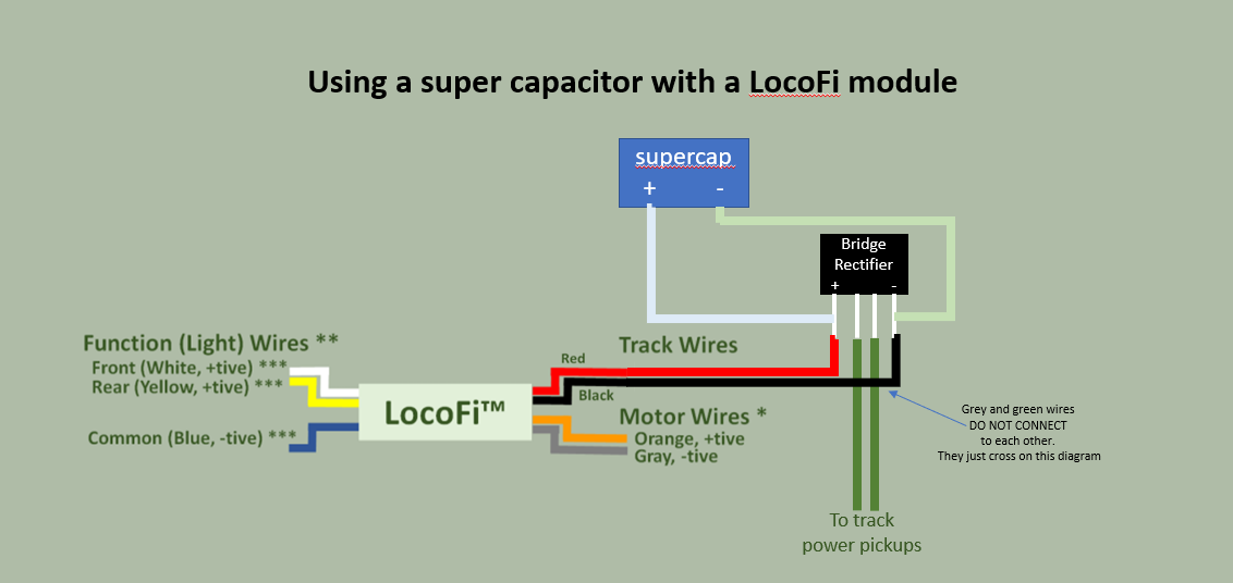

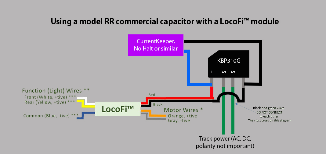

Here’s the wiring diagram I followed when installing a LocoFi module and super-capacitor in my HOn3 RGS Goose.
I used the same bridge rectifier that Loco-Fi recommended for building a power supply filter – a KBP310. I found 20 for $8 on Amazon.
The purpose of the bridge rectifier is to ensure that the supercap always receives power of the correct polarity, regardless of the track polarity or your other wiring. On the bridge rectifier, the two center posts are the ‘inputs’ – they take DC power (from the track in this case) of any polarity. it doesn’t matter which one is + and which is -. Regardless of the polarity of the ‘inputs’, the two ‘outputs’ will always match the polarity labeled on the bridge rectifier body.
Please note that the diagram just shows random wire colors for the supercap – I don’t know whether or not they are standard between manufacturers. Be SURE that you know the correct polarity of each wire from the supercap, and that you connect them to the correct outputs of the bridge rectifier – see the warning below.
The supercap I used is a TCS KA-4. It’s the largest capacity that I thought I could fit in the Goose body along with everything else – the LocoFi module and speaker, the bridge rectifier and all the wiring.
WARNING: It is VITALLY IMPORTANT that you use a bridge rectifier and that you connect the supercap’s wires to the correct polarity outputs on the bridge rectifier. Connecting any capacitor to the wrong polarity can result in the capacitor bursting, sometimes violently, and it can potentially start a fire. The bigger the capacitor, the worse the outcome.

@scott589 Excellent! Thank you once again for the very informative and detailed post. This is an incredible example of a use case of customer install of LocoFi™ in brass equipment and also using a supercapacitor power bank. We appreciate you sharing this.

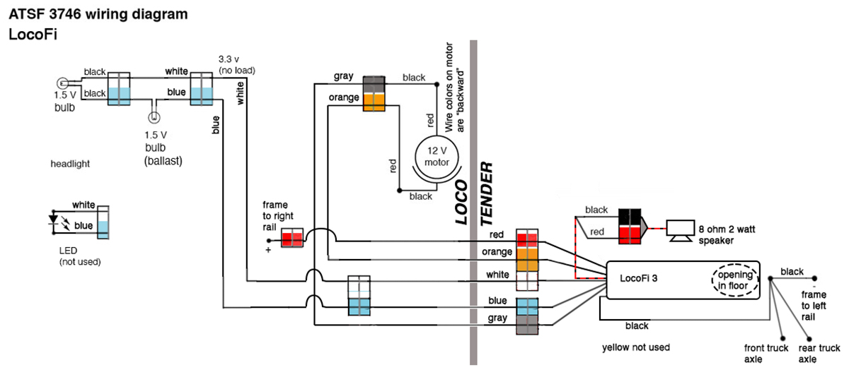

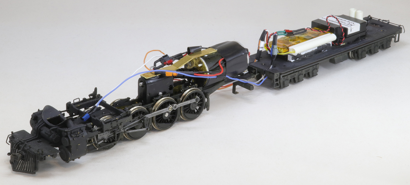

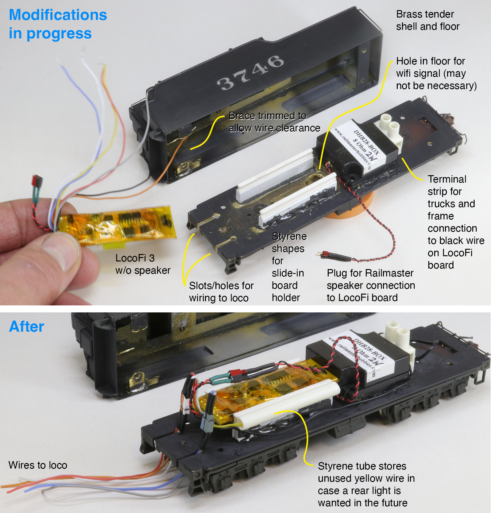

Here is my installation of a LocoFi in an HO Sunset 4-8-2 brass engine and tender.
I set up and painted this loco years ago for DC-only operation but included connectors and a speaker in the tender to make it easy to convert to a DCC board in the boiler later. Recently I revised it to install the LocoFi 3 board in the tender just in case it needed a hole to receive a wifi signal. I had already epoxy glued a speaker in place so I used it instead of the LocoFi speaker. I try to make components removable so I drilled holes and cut slots in the tender floor for the wiring so I wouldn’t have connectors visible between the loco and tender. Later, the visible wires were painted with Tamiya acrylic Rubber Black.
It has a NWSL 240-6 gearbox, an A-Line universal joint and a brass torque arm.
The loco has a 1.5 volt micro bulb for a headlight that I didn’t want to change so I added a second bulb in series so they would operate on the LocoFi headlight circuit. For sound I used Audacity to edit a steam hiss with some clanking sounds for the startup, running and shutdown. I kept the volume low so it was just a placeholder instead of using the “silent” WAV file. When the LocoFi steam sound is released I’ll upgrade to it. I’ll probably also add a capacitor to power the board for one or two seconds — thanks scott589 for the post above on that topic.

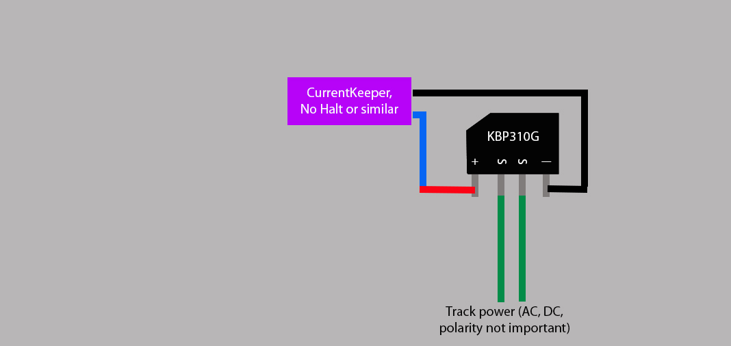

Do commercial devices (Keep Alive, No Halt Insurance, CurrentKeeper) have integral bridge rectifiers? Are there wiring diagrams for the correct way to connect them to a DULLHB?

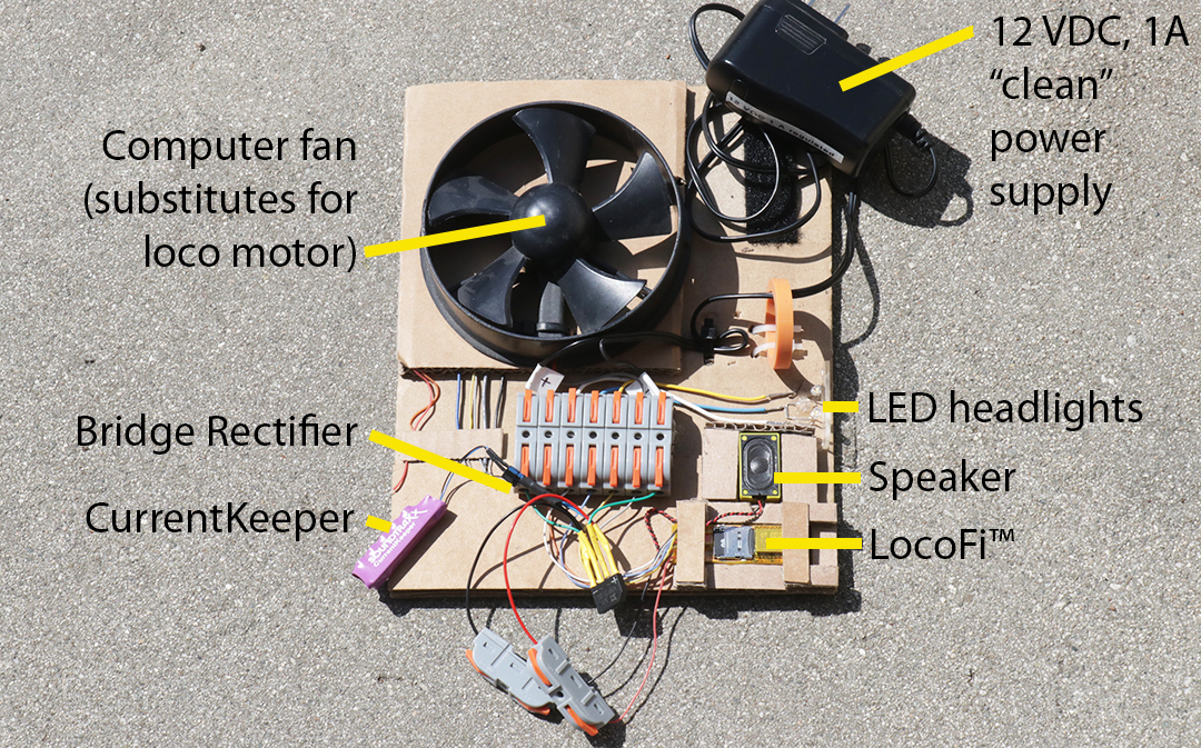

It was a quiet day in suburbia so I hooked up a couple just to see if I could connect them without anything burning up or exploding.
This worked out fine with separate tests of CurrentKeeper only and No Halt Insurance only. This confirmed that the blue wire on both was positive and the black (or black/white) wire was negative.
The voltages on each (measured at the + and – outputs of the bridge rectifier) were slightly different but not enough to matter:
Start: 10.75 VDC
At the end of 5 minutes: 11.25 VDC.
Track power* was disconnected at 5 minutes.
5 minutes, 30 seconds: 10.5 VDC
10 minutes: 9 VDC
* 12 VDC, 1 A "clean" wall wart

Sorry for the delay in responding, and I’m not sure how helpful this will be, but as far as I know (which isn’t real far in this case) none of the commercially available ‘current keeper’ type devices have a built in bridge rectifier. It’s my understanding that those that just plug straight into a decoder rely on the use of a rectifier that’s already built into the decoder board. I’m not an expert on DCC though, so it might be worth a close look at manufacturer’s websites or even emailing a question to make sure.

Thanks, scott589. I agree. I’ve breadboarded the CurrentKeeper and No Halt separately with the bridge rectifier and DULLHB successfully.
In my tests, the CurrentKeeper provided about 2 seconds of power after the input was disconnected. The No Halt was about half that. For a “real world” test I’ll put it in an engine.
I hope that you don’t mind my swiping some of your art for the wiring diagram that I’ve modified.

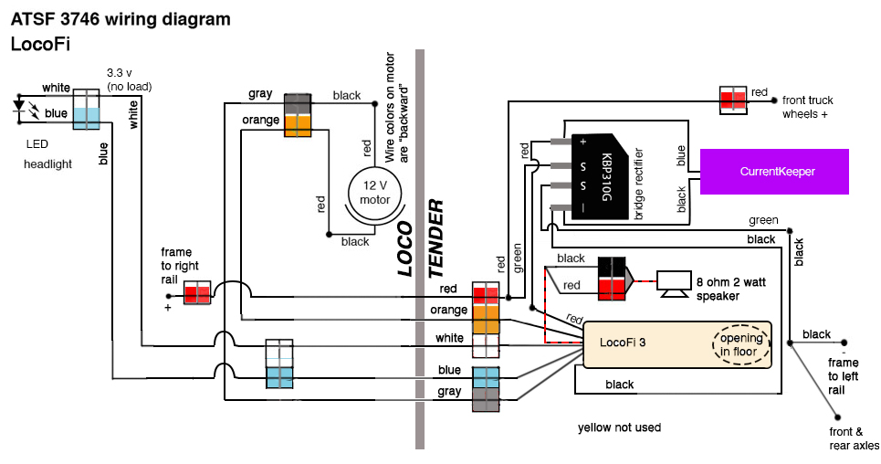

April 24, 2024 update.
Even after all of the work shown above, the loco still had reliability problems. The main one was intermittent electrical contact. I improved the tender pickup by adding phosphor bronze wires rubbing on the axles for the left-hand rail current. I also added a crude (but effective, I hope) contact that rubs on the right-hand (engineer’s side) wheels of the front tender truck with a wire feeding current to the electronics. Perhaps most importantly, I added a CurrentKeeper capacitor and a bridge rectifier. The rectifier takes in whatever current comes in via the rails (AC or DC regardless of polarity) and outputs only positive DC on one pole and only negative DC on another. It’s a bit complicated but it seems to work. The CurrentKeeper adds about two seconds of power to help the loco get past track problems. More testing is needed but it looks promising.

I installed a DULLHB in the brass tender of a Sunshine HO 2-8-0 loco and it picks up the wifi signal without any problem. I drilled holes in the floor of the tender below the speaker. The LocoFi board is mounted with the antenna toward the front of the tender and facing upward.
