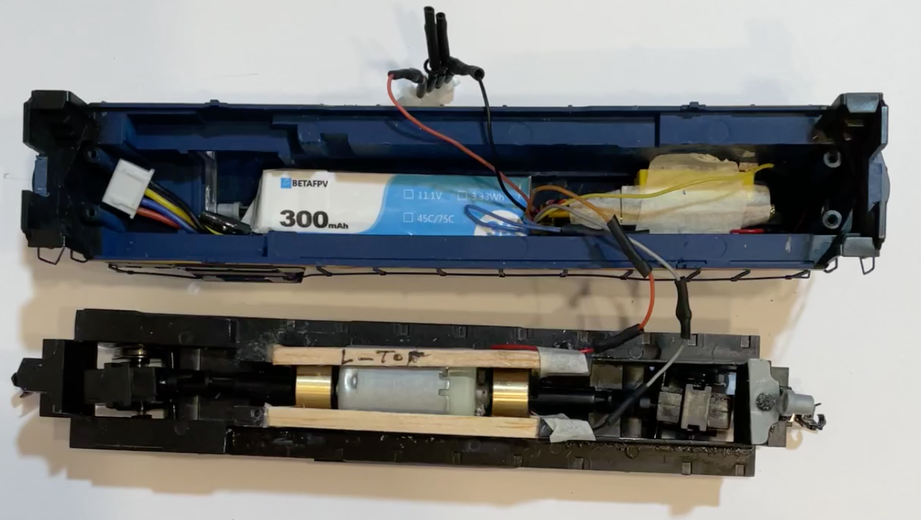

I saw a YouTube video that contained information about, and showed, the inside of the body shell of a Walthers EMD GP15-1.
It looked like one of the systems would work in that loco.

It would have been a super easy install if DC track power was used, as the motor was already isolated from the frame by the factory install of the motor and the lights are LEDs. It would have been a very simple process to remove the PCB for the lights and install LocoFi.
I have two of these locomotives now, and they both run very well on DC track power and battery power, right out of the box.
I wanted to add a battery for Dead Rail operation, which was complicated only by the fitment of a battery and LocoFi into the body shell.
The LocoFi module is in the rear with the speaker attached to it and the battery is forward of that. The rear LED was out of its socket when the photo was taken. It was easily popped back into place.
The LocoFi APP is very easy to use and configure and the module and speaker work like a charm.

Welcome back to the hobby and thank you for sharing the deadrail install of LocoFi™ in the Walthers GP15-1. It’s incredible to see how you’ve achieved fitting both the module and the battery under the shell of the locomotive itself.
We’re glad to hear that it worked out well for you and that you like the app. It indeed is very easy to configure and play around with. LocoFi™ performs best with battery power as there are no “dirty track” issues to worry about.
